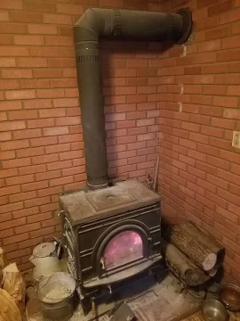

Do you have some pictures of your setup you could post?

Maybe it’s that horizontal run of stove pipe? It may draft better with 2 ea 45 elbows with a short section of pipe between.
It's been like that for around 20 years. Don't know why it would suddenly be a problem like this.
By "problem" I mean it never filled the house with smoke before on a consistent basis like this, that I am aware of.
