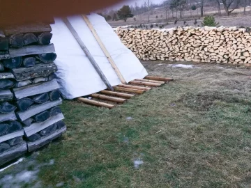

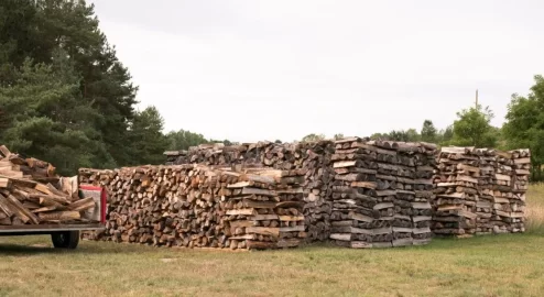

Ed I use home made "
[Hearth.com] Falling stacks
pallets" out of treated lumber placed every 8 ft...I never ever lose a stack this way...3 face cord deep stacked a foot apart for a cord total...works very well.I have this arrangement down both sides of my circle drive holding approx.10 cord...the second picture is of my huge stash out behind the barn that holds approx.20 cord total...the last 2 picture are of the upgrade to the first photo...I suspended slip together top rail post for fencing and stretch a grain truck tarp over it protect it from the weather...it works very well..this spring will bring a permanent wood shed and a solar kiln.

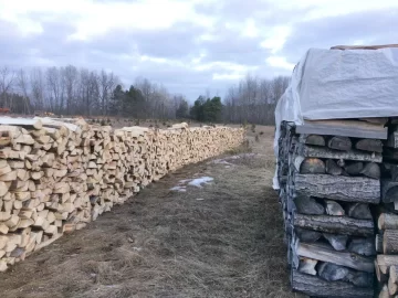

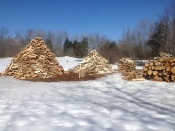

Each large stack has 16 timbers under it. The single row 10 landscape timbers but after running out I rough cut some aspen with the chainsaw to get the row finished. The row will be 115 feet in length when done.

Wow! This is impressive. I think you'd have worked up a lifetime supply here at Chez 3000. I'm hoping I have 5 years. Thanks for the cool pics.
