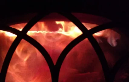

Jotul F-500 hearth mount. Insulated 6" corrugated SS liner about 28' tall.
Tonight has been the first real cold night we've had since I installed the new jotul.
I am burning red oak, white oak and hickory.
So far I have kept the stove cruising between 300-600
Tonight I reached 700 stove top temp measured from the back right corner. Checked with IR.
The arch at the top of the stove in front began to glow a light orange color. The primary was shut down all the way around 400deg.
I got a little nervous and stuffed some foil in the rear main intake tube, the temp immediately began to drop down to 600.
I have seen people say excursions to 900 is ok, but I start to worry when I see orange
At no point was the stove glowing, just the arch in front, behind the glass. I believe it may be air wash?
I tried to upload a photo but it was too big, I'll try again
Thanks for the input, love you guys/gals
Just looking for a little discussion on how hit is too hot.

Yes, it is a new stove. I absolutely love it I'll be cleaning it out tonight to take a peak and see if I damaged anything. I really don't think I did as I got a handle on it quick enough.
I'll have to see if I can check the secondary gaskets, any tips for that?
Well there aren't any gaskets to check, all the secondary components are put together with stove cement and over a long period of time it can break down and fall out causing most of the air to be pulled directly into the firebox instead of to the secondary air tubes. I'm sure that's not your problem since your stove is new, more likely just your chimney height pulling too much air through the stove in colder conditions. I'm guessing your stove will be fine but you'll want to avoid those kind temps becoming a regular thing. Make sure all the gaskets are tight including the ash pan and if they are be ready with the tinfoil or something like my contraption on those colder days.
