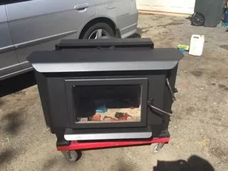

Road trip starts today to pick stove up!:) Leaving at noon today and should be home by 5pm tomorrow with over 1200 miles on the odometer.

Just painted
Looks great!

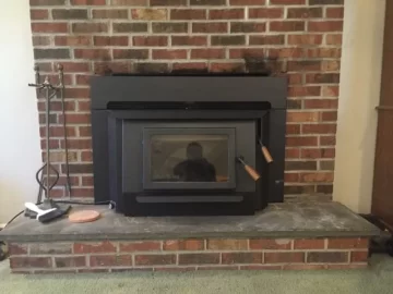

Sitting in it's new home waiting on chimney liner.

Getting close now. Be sure the chimney is completely cleaned (including damper area and smokeshelf) before the liner is installed.
Why? How clean?
I just vacuumed the smoke shelf walls and damper area scraping walls with shop vac crevice nozzle.
Thoroughly clean. Residual creosote is combustible. A chimney fire between the liner and the chimney walls is very unsafe and hard to put out.
Looks like you've got about 6-8" of non-combustible in front of your stove, then carpet below.
I think you want at least 18" of non-combustible...
You might be able to kill two birds with one stone here...in another thread you ask about getting rid of the gap above the stove...
When we installed our insert, we had to extend the stone in front of the stove as well, We had tile level with the floor...so we got two pieces of 2" stone cut to size, one inside the fireplace for the stove to sit on, and the second under and in front of the stove to provide the 18" coverage.
You could enlarge your stone pad -- build it up 2 inches and out 12 (or whatever you need).
Just a thought...
Just a thought...
Adding tile in front of stove on the floor, just waiting on the wife to decide which tile she wants.
