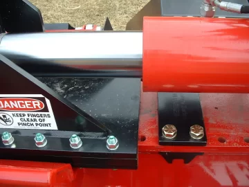

3 years ago I wanted this builder to make me a splitter. He bought a new place and had to build a new shop and being a family man was unable to start building splitters again. I struggled along satisfactorily with a 22 Ton Fast cycle Iron and Oak Commercial unit. It was OK but this one is something special.
It has a # of features:
Folding log table to save about 20" of space
Folding tongue to save about 30" of space
30" stroke with a limiter to whatever you want it to be. For example if running 16", stop stroke at 19".
The hydro filter is the same one that goes on JD giant fertilizer machines and is rated for 125 GPM. The assembling goes all to the bottom of the tank and goes through a diffuser. The tank has two more sets of baffles that the fluid has to draw from the bottom. (heat rises)
Special dump valves to increase flow on return to around 50 GPM
Handles interestate speeds

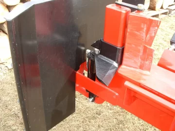

I like the slip down four way splitting wing, that's a nice touch.
Guess you lost me a little, "slip down".
The wedge is hydraulically adjustable. It is vitally important that a 4 way be adjustable so that it functions as a conventional wedge with rounds having large branches growing out of them.
Didn't realize it was hydraulic, I figured it was either up or down. Definitely a fine machine. Do you sell firewood?

Can't tell you exactly, It has a possible 30" stroke, right now the stroke limiter is set to stop it at 21". The other day I was counting Mississippi's and it was about 4.5 sec on split and quick on the return of 3. Since I am a one man band and I stack as it is split, I am only running 2640RPM so the pump is not even close to max flow either. (the hour meter doubles as a tach)
