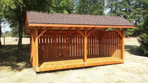

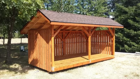

This will be my first full winter burning wood and I decided that I didn't want to deal with pallets and tarps. I have no idea how much wood I'll burn in a winter and my plans started off small and worked up to 8'x16'. Bigger is better right?

Just beautiful.
Did you build or buy? Or did you buy then build? Or did you build and build?
That's a sharp woodshed.!
Just beautiful.
Thank you.
I just looked through hundreds of pictures on google for the design I wanted then made my own plans from there. All built myself.
it's 8x16x6 so if I fill it to the brim I figure it's about 6 cords. Probably overkill but if so then I can leave some space and park my lawn mower in there or something. Or just have wood for 2-3 years. I'm only heating 1000 square feet plus whatever I use for my shop when I'm working out there.

great shed. I want to build something similar, on skids.
Wow, that's a hell of a woodshed. Nice job! Should keep your wood good and dry :cool:
That's a great shed! I have one the same size. Consider putting a narrow divider in the centre (front to back). It allows you too remove wood from one side if you wish and keeps the rows more stable! I left mine open on the back as well so I can remove wood from both sides

That's a nice looking shed. Exactly the design I'd like to build someday. Nice work.

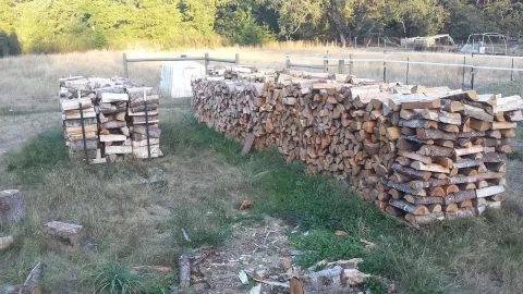

Is that birch I see in your stacks? One of my favorites. Great smell and heat.
