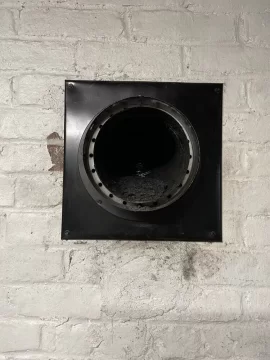

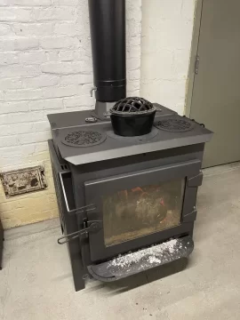

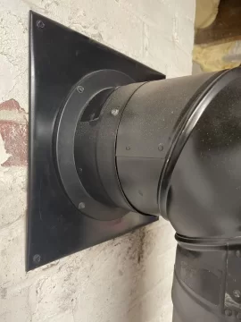

Ok - today I disassembled everything and swept the entire flue. Here are some pictures and questions.... my theory at the end of the thread. I very much welcome anyone’s comments on this continuing saga!
first two are the setup in my basement. Double wall stove pipe comes out of the stove, 90 into flue connecting directly to the liner which curves to go straight up to the roof. That first 90 (where you can see the stickers melted off during the incident) is
[Hearth.com] Fire inside my Double Wall Stove Pipe?[Hearth.com] Fire inside my Double Wall Stove Pipe?

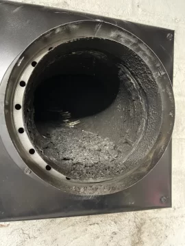

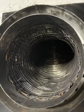

here’s what I saw when I disconnected for cleaning.
So clearly a bunch of creosote falling down from the liner. Seems unlikely there was a fire since clearly there’s plenty of fuel right there?

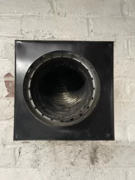

Does this connection between double wall and liner look ok to you guys?

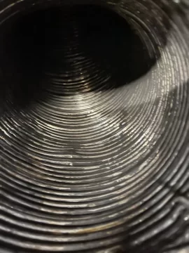

There’s a little ding or dent in the liner... anything to worry about ?
after sweep

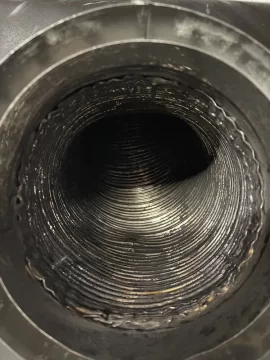

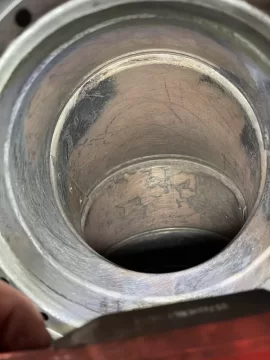

And here is the double wall 90 after I swept it (was a little dirty and sooty.
Should the color change make me nervous / does it mean anything?

Wait so does your liner do a 90degree bend inside the chimney before it reaches the thimble? That's odd I would have expected a tee in there. Anyway it probably works fine as long as it didn't get crushed on the way in.
The color change means your pipe got hot hot hot.. but shouldn't compromise the integrity of it.
BTW, my pipe is also the same color on the inside

yeah it basically just makes a 90 degree curve. I guess they could have / should have put a T in, but I’m not sure how they would have accomplished that without doing a bunch of masonry demolition. Does it make a big difference / any difference? Does the connection between the double wall and the liner look ok? Any issues with those dings and dents? And finally -I guess I could replace the 90 double wall, but if it doesn’t matter I won’t. I have been wondering - there are a few screw holes where the pipe never really lined up — maybe air is getting sucked in there? Seems possible but you are talking about a hole covered by another overlapping piece of metal.....
When installing the liner you can use one of these tees with the removable snout
But if it's not crushed or torn I wouldn't mess with it. And yes it looks fine to me but I'm not a liner expert. The screw holes don't make a difference, especially with double wall.

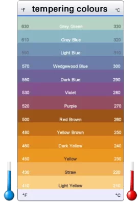

That chart is way below the operating temp of a chimney. Every double wall I've looked at is rated for at least 1000F continuous operation, mine is good for 1200F continuous, and rated for brief forced firings to 1700F, and tested to 2100F in the event of a chimney fire.
That's true, and under normal operating temperatures it is normal for the pipe to become discolored due to the high temperature. However the flue temperature and skin temperature are different things, so when the flue is 1000F, the metal of the pipe may be 500-600.
I imagine the color is affected by more than just temperature. It could also be surface finish, oxygen levels, duration etc. That chart is not from the woodstove industry.
This is double wall, I'm not convinced the skin temp is half that of the flue gas, I think they'd be much closer. Or if he had a chimney fire the flue gas could have been 1200F and the skin temp could have been higher from burning creosote. Either way I wouldn't use the color as an indicator.
Now if there was a picture of the double wall prior to cleaning and it was full of white ash left from burning creosote, I would take that as a reasonable indicator of a chimney fire.
