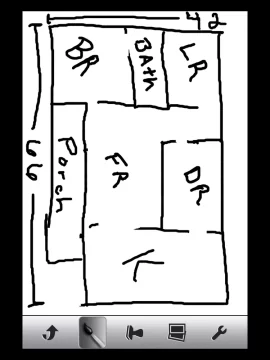

Sounds like 3 cu ft insert territory unless the fireplace room is cut off from the rest of the house by doorways. Can you take the fireplace opening and rear measurements including top and bottom depth? Also could you post a sketch of the floor plan?

A floor plan even rough drawn is going to help a lot!!

Forgive the sketch. My 6 year old wanted to help measure and do the sketch. I wasn't going to discourage her.
[Hearth.com] Fireplace insert advice
Dimensions:
K 23x18
DR 16x12
LR 15x12
FR 18x21
BR 17x16
Fireplace is in the middle of the FR between FR and porch. Fireplace opening is 38W 26H 26D. There are ceiling fans in the BR and FR along with a couple in the upstairs bedrooms.

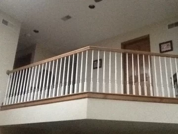

[Hearth.com] Fireplace insert advice [Hearth.com] Fireplace insert advice
For some reason the image is turned on the fireplace, sorry. The second picture is taken from the fireplace looking up toward the other three bedrooms. You can barely see the tip of a ceiling fan blade near the top center of the picture.
Don't worry about the floorplan; a rough sketch is all that's needed. The fireplace is in a good central location. The heat should travel well to most other parts of the house. It remains to be seen how hot the upstairs rooms will get. Keeping those doors only slightly ajar may help to prevent overheating.
The fireplace has a good size for an insert but is not high enough for a stove. Given the 3000 sqft of space to heat you should look for a large insert with a firebox of 3 cu ft or more. Some models to consider: Pacific Energy Summit, Quadrafire 5100, Lopi Freedom, Large Flush Hybrid insert from Travis industries (Lopi, Avalon, FireplaceXtraordinaire: essentially the same insert with different outside looks), Osburn 2400, Regency 3100. If your flue can accommodate an 8" liner the Kuma Sequoia and Buck 91/94 may be additional options. A forum search will give you plenty of information on most of those models. You can also check the review section: https://www.hearth.com/talk/link-forums/stove-reviews.35/ Some of those models have a catalyst which requires replacement usually about every 5 to 8 years. However, you get rewarded with a cleaner, more efficient burn and a more controllable heat output which will be helpful when it is not that cold outside.
