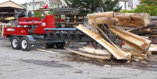

By the way, [said in an Australian accent] "That's no splitter, THIS is a splitter!"
[Hearth.com] FIRST 7 TON ELECTRIC LOG SPLITTER
Forget the house, I live in a pretty woodsy area, I bet I could not get some of those down my STREET!
You know whats amazing about that thing, the little splinters hanging off the "splits", are what I would call LARGE splits!
