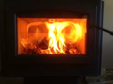

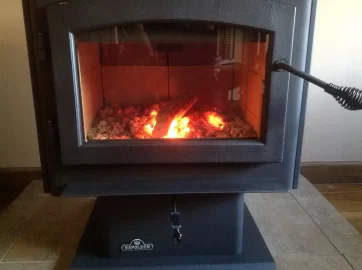

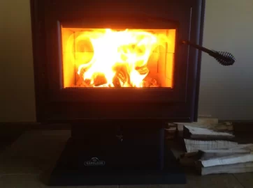

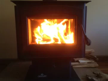

Today was the first fire in my stove. I was burning some kindling to get a hot fast fire. Then a half hour later added some little pieces of wood. Then a hour later some medium size wood. I added some more medium size pieces again 1 more time a hour later. Now it's been 4 hours later and is cooling down. I think 4 hours should be good for the first break in fire. I will do the same fire on Friday. Hopefully after that fire I won't have any smell from the paint curing.

Well, usually the first burn is just the kindling fire. Regardless, you're off to the races now and it looks like it got hot. What was the max temp on the stove?

That seems a bit hot for the first fire but perhaps this stove will be okay with it. I'm not so sure about adding wood that often either. Rather than adding a little bit after an hour and then again after another hour. Why not just put the wood in and let the stove do it's thing? But I understand with a new stove it is common to want to fiddle with it. Have fun.
The draft looks decent. Was there any smoke spillage when you opened the door for loading? How far closed was the air control at full burn?
I don't know how hot the stove was. I have to wait for the stoveThermometer this week. There was 1 time the top of the stove was smoking for about 10 min. I guess that was the paint curing. I never had any smoke enter the room from starting it to reloading it. So guess the draft is going to be ok. Should I load up the stove next fire and lower the air for a longer burn. Or run the same small hot fire for 4hrs until the 3rd fire.
You have already passed the small fire stage. Might as well start it up again. But this time pay attention to how the air control affects the fire.
Closing down the air will intensify secondary burning and will get the stove hotter. Load it up like before and then incrementally lower the air supply. Lower it until the fire just starts to get lazy and stop. Let it burn like this until the flame grows regain intensity. Then repeat the lowering of the air supply until the flame are lazy again. By now you should be down to about 3/4 closed. Repeat if you can (depending on draft this may be the ideal running spot for the air control).
Should I wait for the thermometer, or just load it up and run it like you said. I just didn't know if it was ready to run like that. I might just run one more medium fire then run fully loaded.
No need to wait with that same amount of wood. I would hold off on the full load until you have done a couple test runs learning how the stove behaves with the air controlled down. A thermometer will help you learn what is happening too.
If it was me I would get the thermometer and read the stove manual to find out where the manufacturer recommends placing it on the stove to get your readings. No rush with building big fires before you know more about what the stove is doing. The last thing you want to do with a brand new stove is go too hot right out of the box and end up damaging it. You mentioned on your first fire you had the paint on the top smoking for about ten minutes and that makes me think that might have been a bit more heat than what you usually do on the initial break in fire. Good luck with the new stove.
