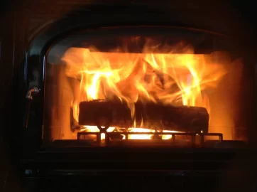

    I often have ONE split in there on the hot bed of coals, I don't think that is over firing it....

    This is a picture of 1 split with secondaries....

    We can't describe nor envision every possible way there is to burn wood here. Most people do not burn one split at a time except to burn down the coal bed. Or in your case, a big split that is on a couple sleepers on a hot coal bed. That's not what's being discussed here.
