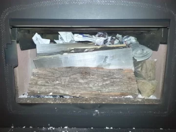

Here is how far I got it loaded up:
[Hearth.com] First fire!
I'm kind of stuck loading up EW. For NS, the logs would have to be cut to around 15 to 16"

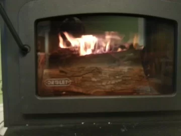

Hour later the stove top was at 450 deg, flue at 500. I did close the air back to 50% but because it started to die down, I had to open it back up. (ignore the dog in the reflection lol)

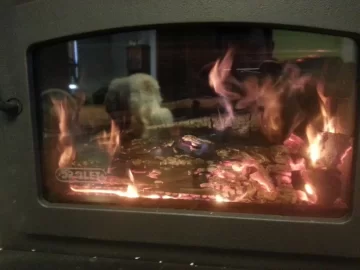

After about a half hour, I got the stove top back up to about 475. I closed the air back to 50% and here is what it looks like:
Right after I closed the air to see how it would react:
It started to die back so I opened the air all the way. The stove top got to a little over 500 with a strong fire, then I closed the air down to see how it would react then:
I also then turned the stove fan on. The stove top went down to about 450 where it stayed for about 20 min before slowly dieing down.
From the videos, does it look like I have good enough draft? There wasn't any hissing or bubbling while the wood was burning, so I'm 90% sure that it's dry enough. Maybe I need to make the splits smaller since it's a smaller firebox? Or maybe I need to just wait for it to get really hot (like about 500) before I start to turn it down?

I think your draft is ok. You need to get a good coal bed and the stove needs to have sustained temps. Start turning the air down when it gets to 400° or so. Just do a little at a time. They all draft a little different so do what works best. Also when you turn the air control down give it some time to react. It will put on a good light show easily.
