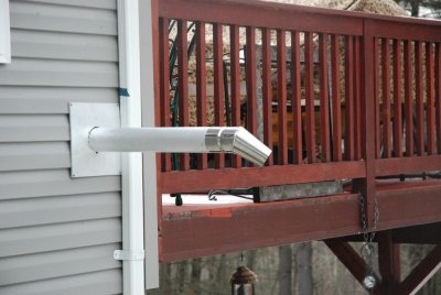

I installed my first stove, a Harman P43 on New Years day.​
I used Excel venting from ICC. I used a 1' section off the stove adapter, a 45* elbow and a 3' horizontal run with a 45 degree termination.
This makes for an easy, clean install, but with the lack of natural draft, you should use a battery backup to exhaust the smoke during a power outage.
Not sure which software/board version you need from Harman, but mine senses the outage, and surges the combustion blower till the smoke is exhausted, however, to my knowledge,these will not operate the stove other than what I just described. We live in the woods and do get frequent short power outages, so it gives me enough time to switch over to our generator.
