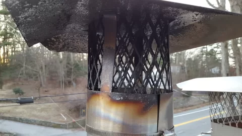

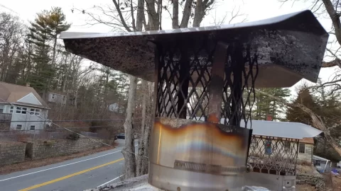

I've burned around a 1/3 of a cord if I had to guess. Got up on the roof and this is what the cap looks like currently. Is this dangerous? I'm trying to wait till after Christmas to clean because I am getting a sooteater as a gift. I live in a ranch and the roof is very easy to get on. Does it look like it's getting to hot up top? [Hearth.com] First year burning. How often to clean? [Hearth.com] First year burning. How often to clean?
Looks like it was already on fire. See the heat coloration on the SS?
That was my concern. Pretty sure it wasn't on fire ever but who knows. It's only 13ft of chimney. The hottest I've registered the flue collar was 580
I see no evidence of a fire that discoloration is common. As far as cleaning I don't know the cap will usually be the worst part.
I guess with that short of a chimney the cap would be pretty hot. If you get it that hot its probably pretty clean down through.

I'm going to clean it right after Christmas to see what I get. Can't hurt. Thanks bholler I was hoping you would chime in. I'll keep an eye on it often.

I purchased a house 2 months ago so I have been using mix of dry and wet wood. Mostly in the 25-30% range. Some higher. Some good pieces in the 15-18 range but not much. Mix of soft and hard wood. I burn hot except for when I leave the house or go to bed. Just cleaned and got less than a 1/10 cup of black. Single wall pipe (I think) between 12'-14' high. Cap was very dirty but otherwise not as bad as I thought. My cap is almost completely black.
My Regency i2400 from my other house has the same discoloration as yours but on a 30' pipe insulated. Installed 10 months ago. If I go on the roof tomorrow I will take a picture of both for you.
