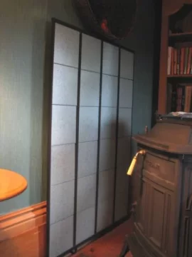

The tag on the stove says March of 82, so not too old I guess :P It has a shield on the back and states 17" to a combustable wall from the back. Now, it came with single wall stove pipe but I'd like to reduce clearance, so I'm thinking about going double, as well as purchasing a heat shield to reduce clearance even more. I found this one locally:
Good idea?

Thats a VC vigilant in your pic?
In the last pic it's just the heat shield that I'm after, not the stove, I have already purchased the Fisher Honey Bear.
