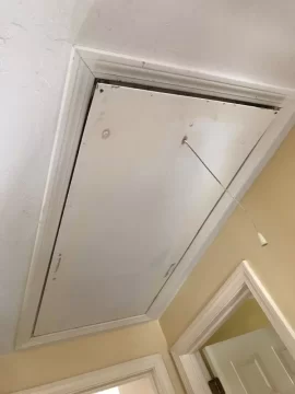

We're doing some work on our house, including blowing cellulose into the attic. That part of the house is accessible by a pull down attic staircase, and once the cellulose is installed, I won't be going up there much.
The insulation company has already installed a rigid insulation box over the opening. I'm thinking I might want to augment that box with another layer of rigid insulation for further R value.
The trim panel underneath the ladder is warped at one end, and I'm thinking about whether I want to replace that panel with a new piece, or perhaps cover the whole thing with another thin box assembly that would provide further air sealing. That would install below the ladder, against the ceiling.
Thoughts and comments appreciated!

I'd replace that panel with one not warped. Then I'd install good seal strips all around, from above, to fit well against the panel. I'd also install a latch or perhaps a pair on the end opposite the hinge, to provide a positive fit of panel against seals. Those springs aren't strong enough to do that. Make sure the wife doesn't forget you're up there installing the seals, with the panel latched in place. Bring cell phone, in case that's intentional.

Have you been up in the attic and made sure the pins or springs aren't loose? The springs on mine pull it up tight but I would imagine with years of use the could become weak or the pivots worn out. Just hate to see you put up a new board and have a pivot or spring worn out on 1 side and it still does it. I'd just get up there and have someone push up and check everything.

I'm getting very good sealing with the box the insulation company built. The box has weatherstripping at the bottom edge, all around, and provided velcro tie downs at each end to cinch the box down. They built up a flat lip around the opening in the attic and the box seals nicely.
I'm mostly concerned about esthetics with the ladder assembly itself, although, if I can get a second gasketed sealing, that would be good. That's why I'm thinking about putting my effort into making an underside cover, which would seal against the ceiling.
The ladder cover itself will never seal well, unless I significantly add to its weight to make it less likely to bend when I pull it down...

I put felt strips on the hatch, and added two latches. I built a plywood surrounding in the attic around the opening (I added r38 batts to existing r19) with a ledge on the sides above where the folded ladder sits. Then I used pink foam board to make a "lid" and glued some leftover r38 batt on there.
Measure well so that the pink board sits snug.
So my hatch is more or less airtight and has r40 insulation (and an air volume where the ladder sits). And I can easily lift it out if I have to because it's so light.
Cost me all of 10 bucks (pink board and felt strips; plywood was reuse and batt was leftover).
Now if I open the hatch and stick my head in there before taking off the pink board in winter, it's nice and warm there. So the air volume where the ladder sits is not cooling to the attic in any way.

I actually just found zip around enclosures that can be put inside to seal it, kinda like an insulated tent. I'm hoping that'll work since I have zero carpentry abilities . Amazon and lowes carries them and they fit standard attic doors
I added one to mine. And some pink board on the back of the plywood behind the ladder. It helps. Better than what I had. Not really what I wanted but better than nothing and took less than 30 min.
