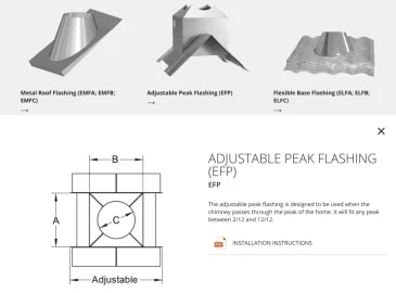

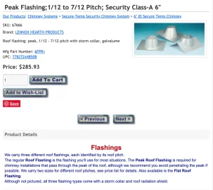

Excel and Security make roof peak flashings.
http://icc-chimney.com/en/excel
(broken link removed to http://www.hartshearth.com/productcart/pc/viewPrd.asp?idproduct=5179&idcategory=548)
[Hearth.com] Flashing Suggestions? [Hearth.com] Flashing Suggestions?
