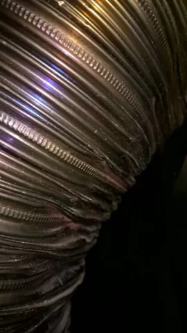

hi everyone, so I have a stainless steel flex liner running up an existing masonry chimney (the previous home owner did this, not me). I was checking it out today and I noticed that the liner has some dents in It (see attached picture). Is this anything to be worried about? I'm assuming it occurred when he put the liner down the chimney or possibly from a chimney sweep?
also, you can notice the guy didn't insulate the liner. Should I pull out the liner and wrap it in an insulation blanket?

Looks a lot like my install.......I feel my chimney is so well built that it could hold a nuclear reactor in check........but not knowing anything about the construction of your chimney the right thing to do would be to insulate it, although it doesn't look like you have the room for insulation below the damper. Small dents I wouldn't worry about.
Thanks for your reply! It is a little tight at the damper - I might just try to shove some blanket insulation up there towards the damper and towards the top of the liner. I would hate to pull it and do more damage to the liner.

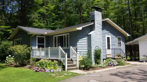

I'm somewhat confused on the whole clearance thing - can you explain it to me? Here is a picture of the exterior chimney that the liner runs up through.
[Hearth.com] Flex Liner Advice
http://www.rumford.com/code/clearances.html
Here is a copy of the code. Generally it is a safe bet that you dont have proper clearance I inspect lots of chimneys and I would say less that 1% have the required clearance

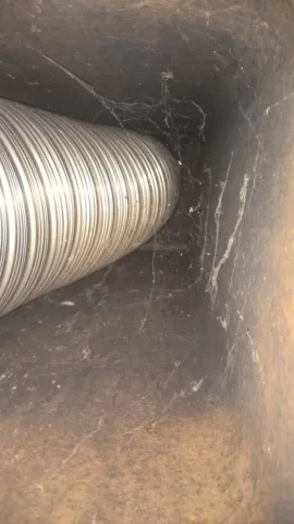

  1. I found that the liner with insulation is going to be too tight of a fit. I also noticed that the terracotta flue seems to be in decent shape, but the joints between the flue sections seem to be missing mortar..probably not ideal...image below is looking down the flue from top of chimney.
  2. I found the original manual for the flex liner (the brand is MagnaFlex), and it actually states not to put insulation around the liner...so now I'm just confused since I thought this was best practice, especially if the terracotta isn't in great shape.

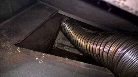

  3. I also noticed some discoloration and a potential weak spot where the liner makes a slight curve at the damper...see image below..is this concerning?

This needs the context that is in the first thread. Merging for greater clarity.
Discoloration of stainless is normal with heat.
With your short chimney I would toss out the 5.5" insulated liner idea.
I would get a quote on busting out the terracotta so you can fit a 6" insulated liner down.
