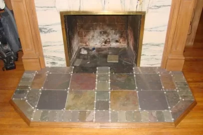

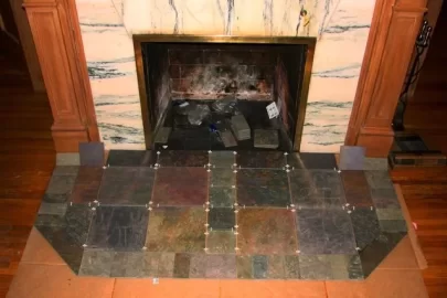

Thanks. I built the pad using (carefully selected) slate tile from Home Depot. I took pictures of the entire process if you're interested.

Oh I'd love to see pics!!
Home Depot really?? I thought you had to order special "rated" stuff.

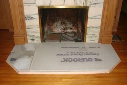

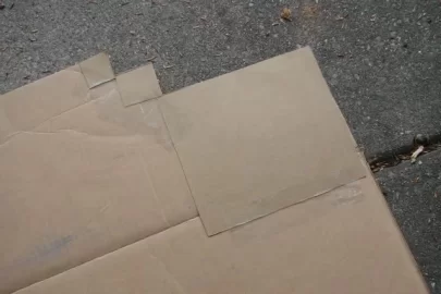

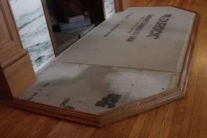

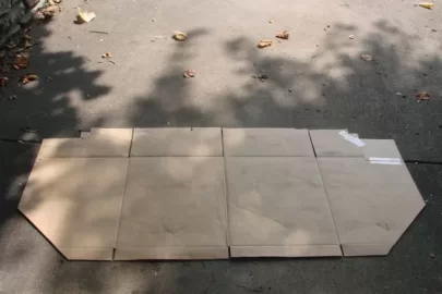

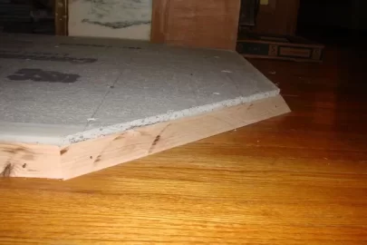

Here you can see the cardboard template I used. That helped tremendously in getting the plywood based and then the other two layers to fit the fireplace surround exactly. I was able to trace the template onto the the plywood before making the cut. The little wedge pieces around the edge in the picture with the cement board provided a base to attach the crown-moulding-type trim to. According to Woodstock, all you need is at least a half inch of cement board and a quarter inch of non combustible (stone or ceramic tile) finish material. I think you also need to use thinset mortar rather than mastic to affix the tiles.
  • [Hearth.com] Formal living room stove pics?
    Durock w: trim base.webp
Thanks for those pics. I could do that I know I could. That trim, you get it finished just like that at HD?

Building a hearth . . . save your money. Yes . . . you can build one that is as good looking, if not better . . . and you can customize its size, shape and R-value to your own needs . . . since the hearth really depends on what you have for a stove (i.e. larger stoves generally need larger hearths and some stoves only require ember protection whereas some stoves require significant R-value protection.)

In terms of building a hearth is it always a similar process (template, plywood, durrock, tile/etc., wood trim)?? Or will other materials be called for sometimes?

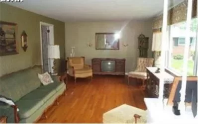

BrotherBart said:
Where is the pic of the living room where this stove is going to be installed?
Pulled from the other thread for you...
