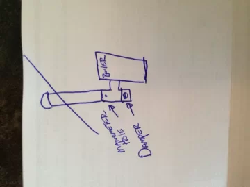

That's a crude drawing of how it's set up. What do you think?
My chimney can't be any taller than 15' total

I don't think you're getting a good draft reading of what your boiler is seeing, with the manometer hooked in there. Look at it this way - the chimney is drawing upwards a 'full draft'. That's what your manometer is seeing. Below the T, the draft is split so some is coming through your boiler & some is coming through your baro. So I think your boiler is seeing a lot less than your guage. I'd move it to just outside the exit collar of your boiler. Also, relatively speaking, that's a fairly short chimney so I'd suspect (seat of the pants) you won't want your baro to be open much at all, except maybe when the wind is blowing.
Yeah that makes sense. I'm out of town for work for two weeks ill have to play with it when I get home.
Thanks for the clarification
What about my T placement. I kind of just slapped it in there. Is it ok being below the boiler outlet or does it need to be upstream in the chimney
