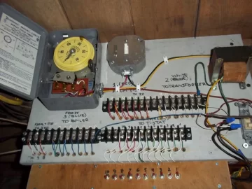

Good post. I always worry about the freezing pipe issue. I was in my basement with the thermometer checking pipe temps to make sure they will not freeze. I have pipes that run along stone and foundation. Even though they are inside and not buried in a wall cavity, not running heat and air leaks in the building envelope can lead to a partial or total freeze in long stretch of cold weather.
Zones can be heated, off, or on freeze protection cycle, as selected by row of toggle switches at bottom.
Timer activates freeze protection zones every so often according to timer wheel program.
--ewd
--ewd
Wow! How many zones are you controlling? It looks like a lot!
Lessee, office, 4 bed, 2 living, 2 bath, kitchen&dining, yep that's ten. Kicker is that it's just the two of us except for holidays and other guests, so it's nice to seal off most all of the house and hunker down in the living and bedroom, during the week at least.
Zoinks....Your plumber must have retired after that job.
