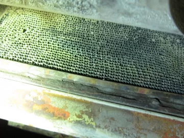

Chris, I've never removed it and can't quite tell from looking: is the cat in my Princess (purchased in 2009 or so) a ceramic or stainless substrate ?

There are some handy draft meters, but none of them are cheap. The least costly that still work well are just over $200.00 As for your combustor, it is probably ceramic.

Here's a picture. Doesn't look ceramic to me. But it works fine (nearing end of its 5th winter). I'm wondering whether to switch to ceramic when I have to replace it though.

That is not ceramic

Didn't think so. I think Chris said in another thread that some stoves shipped with metal substrate. I've always had ceramic before this (in Dutchwest) and can't really tell much difference (in the cat that is, heckuva lotta difference in the stove ...)

I am experimenting right now with a ceramic cat in my Ashford. It came with a Stainless steel cat. So far I am noticing longer and hotter burns.. A little premature to draw a conclusion just yet but will post my results when some time has gone by.
