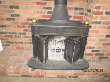

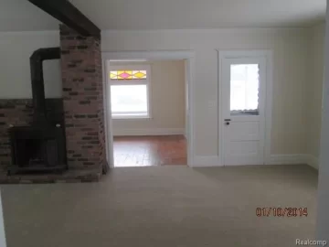

Well, I bought the house recently. It had a franklin stove in it that sat on a huge hearth. I removed the franklin and cut the brick hearth in half, width wise. Had the intention of putting a smaller wood stove if all was well with the chimney. But I don't know now since this seems to be an added cost I wasn't expecting. Here's some pics of the old hearth and stove, and what I was thinking of getting to replace. So I haven't actually used it at all myself.

That little englander 17 is a very small stove. What is your hopes for the stove to accomplish?
Agreed. How large an area do you hope to heat with the stove? Will this be an occasional fire, maybe nights and weekends or would the stove be burning full time in the winter?
Also, the hearth is not nearly deep enough for the Franklin. It's good you took it out. The new stove may also need the hearth extended. We can help you with that once the actual stove is determined.
Not really trying to heat the house just want a fire I can see, more aesthetic than anything. I do prefer real wood fire. According to the specs on the Englander it seems like it will fit fine with no alterations. If it comes down to it, there will be no stove there, if it's going to cost me $350 for a cleaning and another $1500 for a liner. The stove itself is only $600...
Just throwing it out there, but you are looking at a realistic 3 hour fire in that stove. If that works for you, then it works.
How deep is the current hearth? Looks like about 25-27"? The stove is 12.5" deep and requires at a minimum 8" rear clearance with double-wall pipe. That brings us to 20.5" and it needs a hearth 16" in front of the glass for a total minimum hearth of 36.5". I think you'll need to plan for at least a hearth extension board in front of the hearth. It only needs to be ember protection for the 17VL. These can be found for under $100, or you could make one of your own out of sheet metal.
