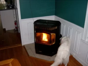

Hearth pad for the stove should be simple... I did 3/8" plywood then 1/2" durock then 1/4" ceramic tile and added oak edging.
I'll post a pic of mine later.
I skipped the log set. it will look good when the stove is not in use, but during operation the logs interfere with the airwash and the glass gets sooty pretty quick.

Here's a pic

GVA what is with all the wires hanging one in the kitchen one going to the stove. ;-P
Ahhh it was a prototype system to have the stove call me if anything was wrong.... :)
I was trying to compete with spikes summit at the time. Where is he anyway????
No the one by the stove is the temp sensor I like it up the wall a couple of feet stove seems to run better there than on the floor as the door behind it is to the basement and leaks a bit of cooler air up.
The phone wires tangled in the extinguisher I had shortened since then
