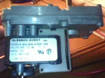

Took my auger motor off tonight so that I could get a make and part number so that I could source a spare but could not find any markings. As I understand it is either a Gleason Avery or a Jakel. My stove is the Advance. Does anyone know the manufacturer and part number ?
Should be a Gleason Avery made for Harman Exclusively
EDIT P/N on mine is 3-20-08752 Harman #
GA # is 904-2520-A1506T-666
But GA only makes this model for Harman...

Regardless of date, the Advance uses a 4 rpm feedmotor, Harman part number 3-20-08752. This part should cost you somewhere around 90 bucks.
Oh, by the way, Harman uses Gleason Avery, Jakel, and Merckel-Korff feed motors. The MK has a different sized output fan shaft as well...smaller.

Driz it's fairly hopeless. Using my contacts in the industry I contacted GA directly about this motor and they were reluctant to give me any info on the motor but From my own info and the specs GA did give me there are some that are close in Grainger but not close enough... I think the stove control board would throw up certain faults if the Rpm were not exact at the 4RPM and most that were 4 RPM didn't have enough torque. The ones that were close enough IMO were about the same price as one from a dealer about $78 last time I bought one..
