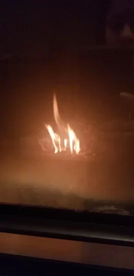

Hi everyone! I fired up my stove today for the first time since I bought the house in April. I started out with feed at 3, ignition on auto, mode on room temp, and temp to 75. I got a great fire but then it started to die down and I noticed that the distribution blower wasn't blowing nor was the light on. I played with the settings going to stove mode (still on auto) and all dials on full blast. No joy. I called Harman. Woman told me to call a servicer. I called a servicer and he suggested test mode to make sure the blower actually works. I chit it diwn and let it cool. Ran the test. Test ran successfully. I set the stove to stove mode, feed at 5, and temp at 6. No distro blow. I toggled the ignition switch. Nothing. It still periodically kicks on the feed motor and the igniter but the flame is consistently weak. If I shut it down, the distro blower comes on. I've read through these forms but haven't seen an issue like mine. I have a feeling the ESP may need to be replaced but wanted to get other opinions. I'm waiting on a call back from the servicer for a service appointment. I've attached some pics to give you a better idea of what I'm seeing. Thanks for any opinions or guidance you all can offer.

Flame looks like there could be a vacuum leak somewhere. Check your doors and hopper lid for tightness. Have you also cleaned the stove and vent pipe?

That flame looks lazy as hell.Potential air leak in one of the gaskets?Also check the trap door under the burn pot and make sure it is attached correctly.
