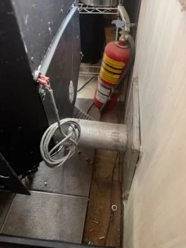

I'm trying to set it up so it comes on and goes off at my comfort zone. Which is around 70-74f. I have the quad set up that way, can't run in on stove temp at this time of year or I'll cook myself. It has a remote with a sensor in it so I can place it any where. The temp sensor on the Harman is limited to 5 feet away from the stove. It's also got a window shining sun on it. So the temp is different a different times of the day. Not like a table in the corner of the living room. So 70f at 7am in the kitchen which is where the stove is, is not the same as in the corner of the living room which gets no sun. Any ways I'm paying attention to what the temps are now to set it at.
I deal with sun where the stove is as well that’s why I have my temp sensor set up like this behind the stove. I get the living room up to tem, leave it on auto light and set the temperature where I feel will be good. If it’s too warm or fires up when too warm I’ll turn it down a bit and leave it. At night I’ll leave it a bit cooler and repeat the process in the morning.
I'm leaving it for the time being, where it is in the picture, I'll have to keep an eye on the temps and figure out what's good for the big picture.
