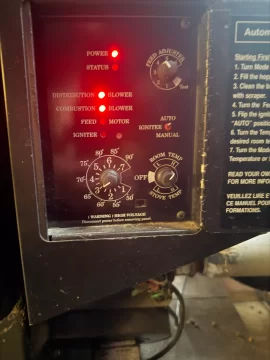

Harman P61 Esp light on fan on full
The Harman can do 1F swing in room mode (with a properly located probe), if it runs in idle mode, in winter, when it's always heating. Once you shut it off, and restart, it will swing like you say.
I did a test on that, and you must be right, it took longer to heat it up then it ran. So no more room mode, back to the stove mode where it can run for hours on end. The Quadrafire is the same, it will come on, go off, come on, go off. The sensor on the Quad is 10 feet away which means it takes 45 minutes to move it 2 degrees on a colder day. It's in the 40's right now. So fire up the Harman before bed time and let her rip all night. It will be in the 70s in the morning.

Just a note, I woke up and it was idling away, even though it was on stove temp. Note sure why? It was set on 1 when I went to bed on stove temp and temps had drop to 72 from 74 same outside temps. when I hooked up the external sensor it woke right up and started pouring out heat. I've changed to the new one and monitoring. I have it set on 75 vs 80 which was the room temp. It's now barely running, looks like it will go out. More later.
Are you sayig the room temp probe wasn't hooked up? If so, I've found that it confuses the stove so it just idles.
I got down to burning embers, no flame so I turned it up to 77 and it started dumping pellets. I'm afraid it was going out. Temp was 78 on the thermometer. I had it set at 75. it's now pouring pellets out and heating up again. So the sensor works just curious why it's really dumping out the pellets. You'd think it would dump out small amounts.
