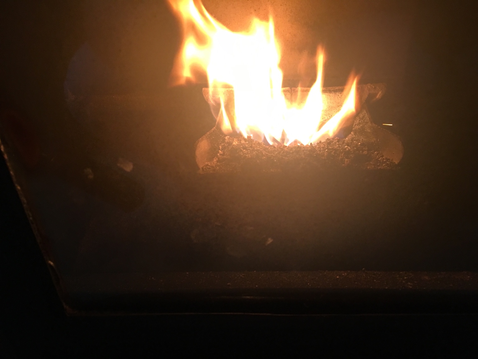

Ok great. That makes sense. My only issue with that is that when it's burning such a small flame so low in the pot, the air that the blower is pushing into the room starts to get cold. I'm guessing I just need to lower the blower speed at that point then so it doesn't take away the heat at fast as the stove can make it at level 1.

That's at about 2. Is it normal to have that big pile of ashes all around the end of the burn pot?
Sounds like its working. Room blower is supposed to shut down when the stove goes to idle mode after cooling it down some. One of the nicer things about the Harman stoves is if the stove calls for more heat it can ramp up faster than a stove that needs to restart.
Normal ! I`ve had my P38 for about 8 yrs now and I can tell you that set at 1-2 the distr. fan WILL cycle on/off since the flame (high) isn`t hot enough to keep the fan running continuously. Mine needs to be on 3 to have the distr. fan run continuously.

That pile of ashes at the lip is normal. Doesn't affect performance but I'll pull it down A few times a day if I notice it. As said above, the low flame isn't producing enough heat to keep the blower operating constantly, which is normal. Esp exhaust temp has a minimum that must be maintained before the blower will operate. The older style 2 dial control board is less nuanced than the new boards, but I've never used the thermostat wires so who knows what I am missing. When my stove is one, the blower is at max and feed bet 2.5 and 4 uusually, which eats bet 1 and 2 bags per 24hr period.
