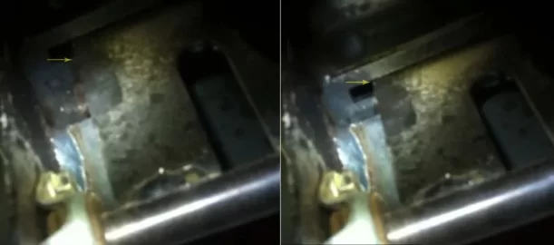

OK, I tried everything suggested and a few other ideas I had. Nothing worked. Too much snow in the drive to get out to the stove store. Lady BK had a snow day today, so she decided to take a look see and she fixed it! Inside the fines box there is a reciprocating plate with a slot in it. It has another plate that goes through the slot, and there was rust at the contact points of these two plates (see arrows in photo). She sprayed it with WD 40 and the squealing sound stopped instantly. So I mixed up some grease with powdered graphite in it and had her paint the surfaces with an artist paintbrush. Looks like some damp pellet dust must have laid in there for a while, causing the rust to build up. Had a big problem with that this year after buying two tons and letting them store them at Home Depot. They left a partial pallet out in the heavy rain we got after the holidays without adequate cover, and many of the bags got wet. I did my best to be on the lookout for damp or swollen pellets/excessive fines, but apparently a few bags got past me. Damn Depot wouldn't even take them back because I had "opened them". Now, how the heck am I supposed to know they're bad if I don't open them? ::-)
Anyway, hope it lasts, but it's a quick and easy fix if it returns. Kudos to the lovely Lady BK for being smart enough to figure it out.
