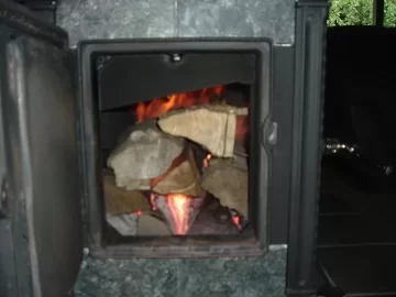

Do you guys completely fill the stove each time you reload, or do you burn one split at
a time?
Also, when the stove is at 500, it doesn't blast me out of the room. I'm sitting on the couch,
about 5ft away, it's not overwhelming at all.
Dale
Yes, I fill it up. Usually. I won't fill up a stove like this when the temp is still 450 but I do like to burn in full cycles as much as possible.
