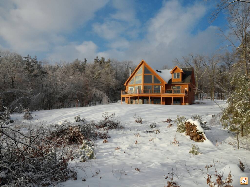

Your house sounds a lot like ours. We've got~ 1700sqft main and ~750 upstairs. Cathedral is 26' high. Jotul F55 seems to be working well. We also have spray foam and batts in the walls and cellulose in ceiling. Super airtight but lots of glass which loses a lot of heat at night but we're south facing so we benefit during the day big time. Here's a pic.

The phoenix is rated to 60,000 btu which should run you out of that room if you are burning seasoned hardwood and operating the stove correctly. I am heating from a 1080sq ft basement, the main floor(another 1080) above and a loft of 200sq ft & the great room is right above the stove. It is 30'x20' with 20' cathederal and big glass similar to jzinc's(nice pad by the way). I can generally maintain 68 degrees on the main & loft with nothing but two computer fans under the floor at two registers & get consistent 8 hr burns when fully loaded for the night...and my wood this year is marginal.
