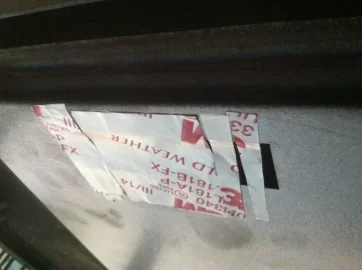

I had to tape over most of the secondary air inlet and when the fire is cooking, I have the pipe damper closed. This summer I hope to install the OAK.

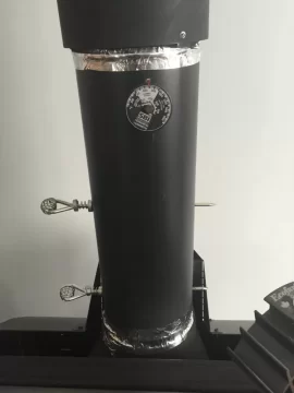

Hey everyone, sorry for the mini rant. So as an experiment I put a second damper in my short test section of single wall pipe and that made a HUGE difference. I have been able to maintain a stove top temp of 400 with flue temps at 600. Much better!

I forgot to mention that I also have a fridge magnet covering the secondary air supply.
So yeah.. lots of draft!
The pic is my test set up.

Here's my secondary air inlet:
[Hearth.com] Hearthstone Phoenix vs Jotul Carrabasset
Actually, I think it may even be a smaller slit than that...:confused:
That is strong draft. Double-dampering sometimes is an alternative. Note that it may be more beneficial to restrict primary air than secondary. Have you tried that? Also, metal tape is not rated for flue temps.
I did try restricting the primary but it didn't work. My plan is to get or make a much better damper for the double wall pipe and hopefully be able to use both air supplies.
