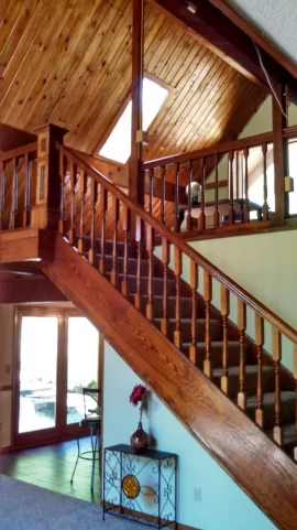

I just read your first post and it looks like I have a very similar house. Ours is 1800 sq ft with a tall ceiling in the living area. It can take a little bit for the whole stove to heat up when cold because of the cast iron jacket but I only notice it because our old steel stove would get hot so fast.
  • [Hearth.com] Hearthstone Phoenix vs Jotul Carrabasset
