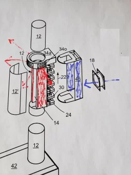

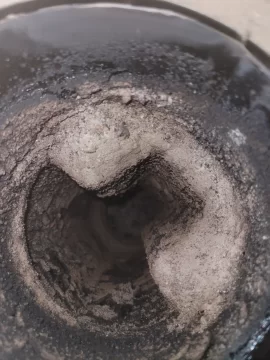

Hello kborndale, long time no talk. Just received pics last week from one of our 2 year case studies. Please see attached pic of unit that did not get cleaned for those two years. Check the buildup and I would like to here your thoughts. While ash is present, no heavy black glaze creosote which I think everyone was predicting. I also have included a pic from our application which shows the general working of Heat-Maxx. Thanks for your help and hope you are well. Ray
  • [Hearth.com] Heat-Maxx wood stove heat reclaimer
That is not necessarily proof of safety or appropriateness, especially for low efficiency stoves. The amount of creosote deposited is going to be in direct proportion to the amount of volatiles heading up the flue. With a very clean burning setup the accumulation may be less. It would be good to also document creosote deposits up high and at the top of the chimney system after this stack robber, where the chimney is exposed to cold air and the flue gases are further cooled down.

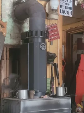

Here's a shot of his stove. I can forward you his testimonial by email if you wish. Thanks Ray

It's not a different idea, it's been around for decades. It takes heat out of the flue and puts it into the room which is not a good thing. Heat with the stove not the flue.

In my view there's a very limited set of stoves still in operation where this thing might have some benefits.
It's old smoke dragons without even a baffle.
But even then, it should only be running when one runs the stove high enough to get that pipe so hot that only ashes deposit there (as in the pic).
And if not, every now and then it still needs to get hot enough to burn the deposits down to grey as in the pic.
I.e. the old fashioned chimney cleaning with a mild chimney fire. And the thing should be close to the stove top.
Other than that, claims that heat is extracted without cooling the gases deserves the Nobel prize in physics. As so far all of physics tells us that is a thermodynamic impossibility.
