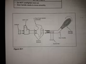

If the bill slides out then remove the nut off the inside of the door's handle. It is best to spray it with some WD40 and let it sit for a few minutes. Again lefty loosy and righty tighty. There are some washers in the handle so switch them to the back side of the lug or add more washers if still loose. Re assemble but do not over tighten the nut or the handle will not turn.
Can I make this any easier???? Lets add pictures.

What do we do if it still comes out with ease? We tried "fluffing" the gasket.
If you swapped the existing washer as per Eric's recommendation above, and the dollar still slides out fairly easily, then add another washer or 2 to the backside of the lug....this will tighten the door against the stove. Try adding one at a time until the dollar can't be pulled out w/o tearing it.
Short of that, replace the gasket.
