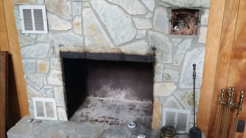

Hope someone can help. We bought this cabin which was built in 1988 and we want to know what type of fireplace it is and what our options are for something that can heat the house better.
Attached are the photos I have.
Thanks
Welcome. Looks like it might be a heatform metal fireplace. You can put in an insert or a free standing stove depending on the fireplace's firebox front and rear dimension.

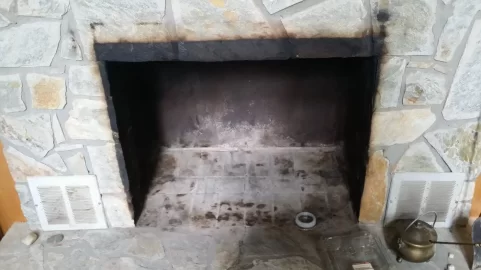

Here are the dimensions
32 wide
26 high
It curves toward the front from the back.
The curve starts at 17 high
The depth is 22, with 16 being metal and the additional 6 being the stone face. At the top of the curve it's 11 deep.

The Englander 13 NCi is an affordable insert that looks like it would fit there. It will require a 6" stainless liner. How tall is the chimney?
