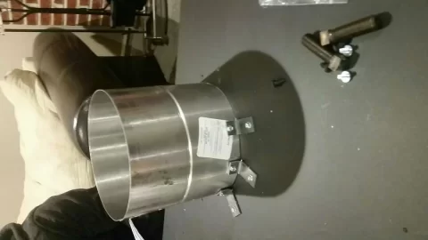

Just got a Osburn Matrix. Thought the tie in point on too of insert "6" round" would have stuck up more then an 1/4" came with 3 small L brackets that screw to top. Question is. Do I screw the 6" stainless coupling that came with Liner Kit to that. And the liner to the coupling. And if so. Do I need to caulk the coupling around insert? What caulk? I stalling it tonight. Wanna make it right.

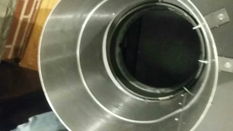

this don't seem right at all. Is this coupling not right. There are tacks on the 1/4" lip. So I can't even recess this any.
I would get an "appliance connector" that is crimped, so that it fits inside the lip. Get the connector that is made by the same company that made the liner. Male end of any piece should point down.

What liner kit did you buy? That thing they sent with it isn't a proper appliance adapter that should have come with the kit. And no, HD won't have a crimped stainless adapter.

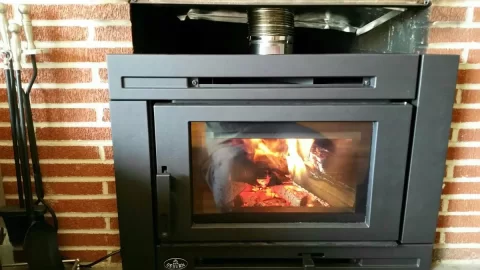

Pulled the liner. Conected the adapter. Have my first burn. But when I leave the door cracked to get the coals hot and the wood roaring. I notice smoke coming down from my block off plate. What do I do. If I made a hole when pulling it down low. Do I patch it? Let it be? [Hearth.com] Help installing new Insert
