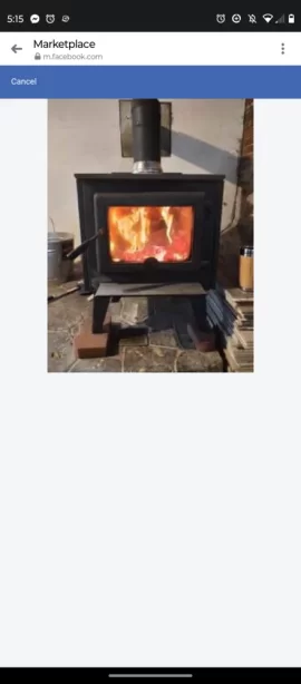

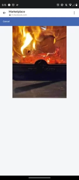

Thank you, this is very helpful! I will ask for photos of the inside, I do have photos of the exterior and will try to attach them here.

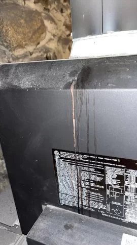

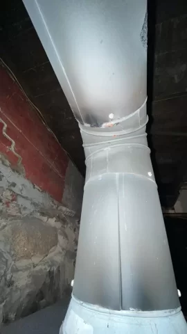

I noticed the back has drips down it. I was told the new stove pipe from home Depot dripped on it - I was thinking maybe it's creosote? You can see it in the photos.

Are you prepared to drive Home empty handed? I drove 2.5 hours one way to find the stove had been left outside and needed a new paint job. (It wasn’t a total loss we got some shopping done at LL bean). Looks like they had the pipe installed backwards and water or creosote dropped down on it. Don’t expect a perfect paint job. The install looks questionable. Raises a small flag for how they might have run the stove.
I don’t know how much a new baffle and tubes are if they are damaged less than $200 maybe.

Cracks, warping and gray paint. Paint is enough to fix. Warped replaceable parts are too. Cracks are harder to fix.

The stovepipe was installed upside down. The crimped end always faces the stove so that any creosote drips back into the pipe and not outside. So far I don't see red flags. See if you can get a shot that includes the stove top too. If the interior shots of the stove look good then I think the drive is justified. The market is going to get very hot any day now and good deals will disappear very quickly. Just make sure they don't sell the stove while you are on your way.
