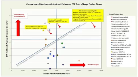

The progress puts out more heat then the Equinox.
Based on what?
You must've missed the graph. ;lol

Nah. I missed the part where the EPA tests have never tested BTU outputs. Tom makes a cute marketing graph.

Apparently the 30 also does while being more efficient
So where do they come up with the "Heat Output" numbers? http://www2.epa.gov/sites/production/files/2013-08/documents/certifiedwood.pdf
Gee, the only cat stoves on the graph seem to be Woodstocks... ;lol
