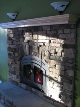

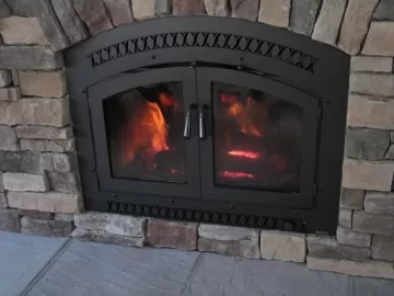

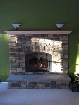

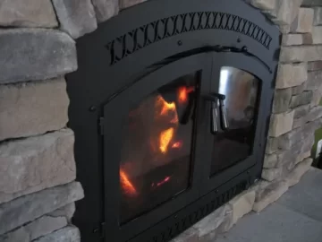

Just wanted to provide an update. The project is complete. We decided on a total tearout and installation of a high-efficiency fireplace. We opted for the FPX 36 and have been very happy so far. I appreciated everyone's insight and opinions on the project. We ultimately proceeded the way we did because we wanted to preserve the original room dimensions as much as possible and had a good idea of how we would use ledgestone and the arched face of the FPX to create an attractive and functional heat source.
We feel like it turned out pretty well and, most importantly, we are warm :)
Thanks again.

Looks great! I think you made a very good choice, I would have (and did) the same thing.

Hi emigma , I love your new fire place . I'm installing the same unit in a few weeks. With the same stone and mantel . No hearth on mine there is not enough room Good luck with it John
