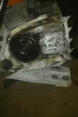

Here are the pics I received from him today:
[Hearth.com] Help with an MS441? [Hearth.com] Help with an MS441? [Hearth.com] Help with an MS441?
He says everything spins freely. I asked if he knew exactly whats wrong or just that it threw the chain, he says he doesn't know. Anyone see anything horrendously wrong in the pics? I've never had the privilege of running a big saw like this, so I don't exactly know what it should look like in there ;em

Doesn't look bad to me. It's low-res and hard to see, but before taking the second pic it looks like he removed the retaining washer and clip that hold on the sprocket and clutch drum. The only thing that's obviously broken is the rim sprocket, and it is totally shattered. But, that's a very cheap part. There's a good chance the washer was also damaged, but that's an insignificant expense too.
The darkness of the dirt and the staining of the plastic under the sprocket-side cover is a little unusual. Makes me wonder whether he was using old motor oil for bar oil. That wouldn't be any sort of death knell for the saw, but maybe an indicator that he's less than fastidious with maintenance (which would be no surprise given the circumstance). You might want to ask what kind of 2-stroke oil he favors, and hope he doesn't say "used motor oil" for that too.
The recoil-side pic looks nice. The dirt and the wear on the handle tell you it hasn't spent it's time since manufacture sitting on a shelf, but I don't see anything too scary. If this is all that's wrong then whether it's a good deal just depends on how much cash he wants along with your 170.

So from what I can tell, assuming the saw needs a new clutch, sprocket, rim sprocket, and little bearings/washers; I'd be looking at around ~150 bucks in parts. But I can't be positive the clutch even needs replacing since we can't see it
Out of curiosity, what happens to a saw to shatter the rim sprocket like that?

I hope not, a new piston is getting out of my college-student price range ;lol. Ill have to check out the bar and the clutch carefully. I assume a shattered piston is something that can be seen from pulling the muffler? Thing sure looks like it was oiling though. A lot!
Oh, I didn't mean that the piston on yours was likely to be shattered, just that a lubrication problem might have put extra stress on the sprocket and caused it to break.
Could easily be that the oil holes in the bar were plugged with sawdust, so the oil wasn't getting where it was supposed to go. When the pump is still trying to push oil into the bar but the necessary holes are plugged, it's normal for it to leak out all over the place and make a mess of that whole area under the sprocket cover.

My guess is that the thrown chain caused the rim sprocket to break.
Poor lubrication would lead to increased friction, which creates heat, which makes the chain stretch. If you are trying to force a saw to cut with a dull chain you can see when you pull it out of the cut that you have a lot more chain droop. If you dont know better, you can toss the chain off the bar pretty easily when its warm like that. (Cant really tell if the chain catcher is bent in the first pic, but if you see it and its mangled, you know what might have happened...) Toss that chain around to where it twists up and wants to stop spinning, you put a lot of stress on the rim sprocket, and a good chance it will break.
Looks like used motor oil to me, or just really dirty cutting. You may want to check and make sure it oils once you get your hands on it, could have a plugged oil pickup.
Probably dont need a clutch, maybe not even a clutch drum, but most definitely a rim sprocket. Since he has already pulled off the washer and e-clip on the outside of the clutch drum, pull it and see what it looks like under there. Thats a good chance to see if the crank is OK. If the end of the crank is at all damaged, you might want to back away slowly.
So parts list will probably be: rim sprocket, clutch bearing, chain catcher. May need others as you dig in, but its a good place to start. Swish some mix in your oil tank to clean it out, then fill with fresh bar oil and see if you can get oil from it.
I suppose the other thing, does it run? You should be able to start it without a bar/chain on it if you put that e-clip back on the end of the crank. Dont rev it up without the load, but hopefully it fires right up.
