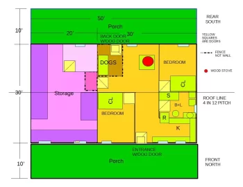

Hi,
I am new as a poster but have been a guest fo a while. Also new to wood stoves. We live in a fairly mild climate. South of Ozark in the hills of Arkansas. We have a lot of big Easter Red Cedar some Oak, Hickory and other trees. Wood supply should not be a problem. My question is how to best get the heat distributed and would super 27 be too big.
The building is 30x50 with 10 foot porches on north and south side. The living area is only 30x30 so 900 spuare feet with 10 foot ceiling. The actual room for the stove is 20x20. Bedroom doors open onto living area with open transoms to allow for better air flow. Hallway goes to kitchen past the bath and laundry.
The stove will be free standing with chimney streight up through the roof. Building has blown in foam insulation, concrete floor not insulated will have bamboo with electric floor heat eventually as we can get to it. However ther is extra airflow fro the dog's flap doors, one in the living room to go out back and one in the kitchen to ho out front.
My husband and i are diy in every way. I would like to cook on the stove, we love good stews and chilli.
We have only 1 dealer in this area who doesn't use a wood stove himself.
We looked at the BK stoves, they are a bit pricey.
Attached is a pic of floor plan.
Thank you for any help you can give.

I am new as a poster but have been a guest fo a while. Also new to wood stoves. We live in a fairly mild climate. South of Ozark in the hills of Arkansas. We have a lot of big Easter Red Cedar some Oak, Hickory and other trees. Wood supply should not be a problem. My question is how big is too big.
We looked at the BK stoves, they are a bit pricey so we hope to be able to go with Super 27 or is that too much?

The building is in the process no wall inside yet. So no never heated before. Trying to upload a pic of what we are planning to do but are open to suggestions for a better arrangement.
Sorry i changed the post a bit.
Cat66
Finally, i hope the plan shows up.

Thanks Dix,
Burn time is not a real problem, usually get up anyway, age you know.
Did you see my floor plan? It's pretty small 900 square feet.
Do you think the warm air will be able to get to the rooms?

Is there insulation under the slab? If yes, then with the foam wall insulation it may take very little to heat the place in most weather in Arkansas. If that is the case then a small woodstove will be best. Some super insulated places heat themselves with just solar gain, appliance and lighting heat. Have any heat load calculations been done?
