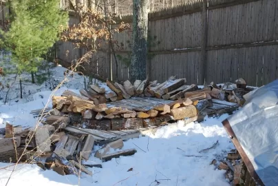

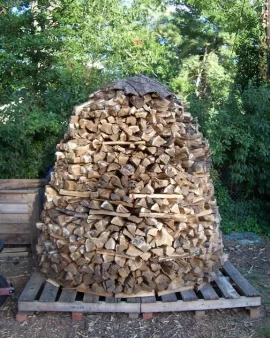

I too do the 4 pallets, I put brick under mine to try to extend their life a little. It doesn't look as nice as having it built right on the ground, but I'm with you, I'd like to burn that bottom row, plus it's gotta help with the airflow under and up through the stack.

Thanks for the ideas. 4 pallets it is.
Use 4 pallets. The pallets distrubute the weight much better and should remain level during the freeze/thaw cylces...

Almost everyone has access to junk wood. Just build the first layer out of sacrifice junk wood and bark scraps. Looks better than pallets.
