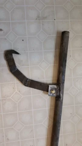

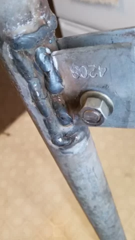

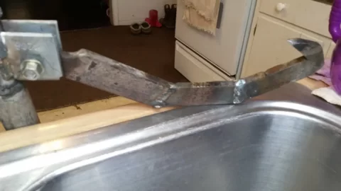

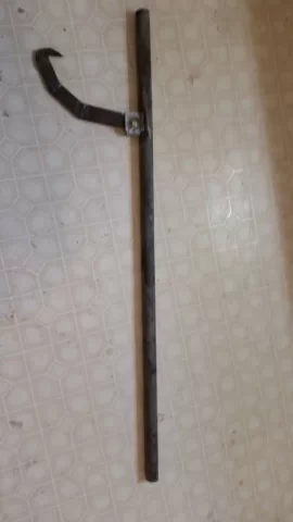

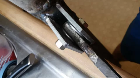

I used some scrap metal to make myself a sturdy all metal cant hook after breaking my antique wood handled one. I just got done making a foot that will fit inside the lower end of the handle and be held in place with a hitch pin that will let it function at a timber jack. The handle is reinforced on the lower half with thick walled tubing driven up inside. And the hook bracket is welded directly to the inner tubing.
Not pretty at all but it seemed really sturdy when I tested it. What do you guys and gals think?

Pretty nice!
Does it work well? Got any action shots to share?
I tested it on an old power pole and it sure bites in deep. Almost buried the whole point. I'm hoping to get into the woods tomorrow if the ground is frozen and give it a good workout.

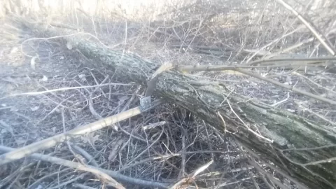

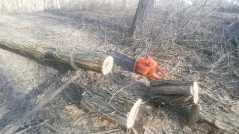

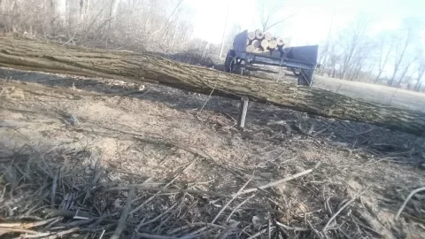

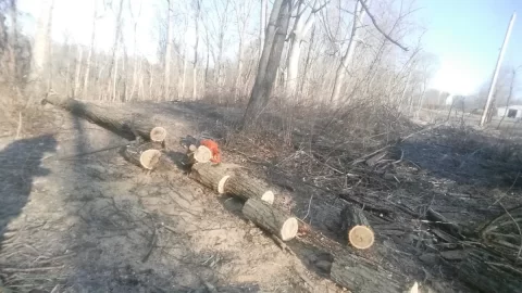

I got into the woods this morning when the ground was frozen and cut some wood. It made a world of difference bucking up the logs. Here are some pictures of it in use.
