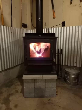

I walked mine up these blocks 1 side at a time the way Highbeam said.
Took 1 hour and did it myself with the door off, bricks in.
