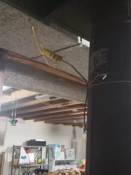

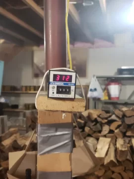

Hi. Just wondering what you guys consider to be the highest flue temps (digital probe 3' inside flue) reading you will allow? I've always used 315°C or 600°F but I'm wondering if I can safely aim more towards maybe 800° or 900°F?
I'm running double wall to the ceiling, on a basement install).

View attachment 289775 View attachment 289776
1000 f max

Thanks for the quick replies. Yes, that is a thermocouple with the tip in the middle of the flue. I'm running a Drolet Austral. I have nasty wicked draft, so much so that I installed a key damper in the flue a few years ago, to help me keep things from getting out of control. I haven't had to use it much this year, but I get nervous when the air is completely closed, like today, but the temps still want to keep climbing above 600 F... So it should be ok to let the flue gasses get up to say 750°F (400°C)? Takes about an hour usually before the flames of hell die down a bit and the temps start dropping.

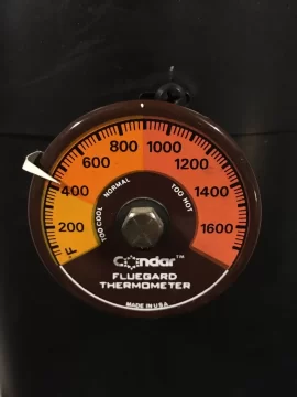

For reference, here is a labeled mechanical probe meter for stove pipe that gives you the normal operating range.

I was very happy with my fire this morning. I turned the air down about 90-95% which still left a good solid box of flames & secondaries, and then let it go to see how hot it would get in the flue. It reached just around 350 F and then cruised there for a good hour or so before starting to slowly inch its' way down. Very happy indeed. Thanks for the comments and advice.
