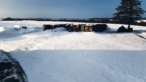

Here is a snap shot I took this afternoon of my current woodpile, 29 cords left pus 11 cords of oak logs I had delivered last Fall, some of it buried in the snow in front and the rest behind my woodpile.

You need to get a cover built over the wood pile.....You will vastly improve the quality of the fuel if you do so....
