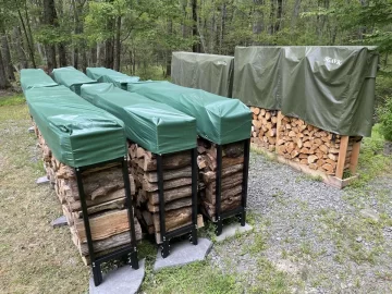

I have covered the firewood in two different styles. i am planning on covering up with tarp later.
Backside firewood is covered 2/3 and front side is just the top.
which one is the right way? or do i need to cover them fully to protect from rain?
The left side, with the shorter covers, stands a better chance for quicker summer drying. Wind blowing through the stacks is quite effective at accelerating drying. It helps to orient the stacks so that the prevailing winds can blow thru them.
i should mention that, the rear side ones [ with longer cover ], i usually leave them uncovered if it is not raining. Cover has easy access zippers. [posted in previous pictures]
