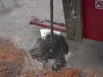

My setup has worked for two chimnys for over 30 years. I drop the rope down the chimney tie a 5lb weight on it, stuff it into the ash cleanout door and pull it up. I clean at the start of the season this weekend and mid season
Elk,
What kinda brush is that?

That is the wad of chicken wire he speaks of so often.

My two wood stoves are vented into masonry 8/8 flues Using a 5 LB weight as a giant washer I bend and streech the wad of chicken wire over it. The harder one pulls the weight like washer pushes out. The proceedure is to drop the rope down the flue. This has been used 30 years so it is formed for the flue and has been pulled so hard that it forms a cone like shape with a center hole for the rope.
I pull it out and streech it tie the 5lb weight stuff in it into the ash cleanout door. With the help of a 2/4 I pull it up the flue wraping it around the 2/4 and if I get resistance the 2/4 acts as a lever. Ever hear of the chain method. Drop a chain down with a weigh and swing it agound It will knock off any stuborn cresote chunks.. I thought about getting an 8/8 wire brush even borrowed one and used it, but It did not work any better.
